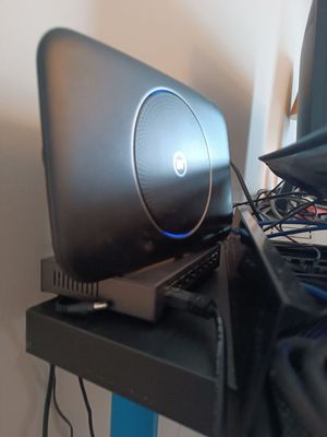

Contacted BT Support via https://www.bt.com/help/contact-bt/technical-support/full-fibre (Message Now button), got through to a human advisor and, while we were going through the standard checks, I realized what is the difference between my set up at the old address and the new one: I put the Hub on top of the NetGear Ethernet switch, like this:
SmartHub_on_top_of_switch_is_BAD_IDEA.jpgAt the old property I had them standing next to each other, about 20-25cm apart. As soon as I powered off the switch - the problem gone for good.
So I just moved the switch to the other side of the monitor, 60-70cm from the Hub and all works fine now.
