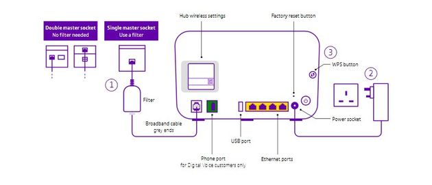

Have you connected it up as shown below?

Yes, although as there is a double master socket I haven't used a filter, just connected directly to the broadband port.
