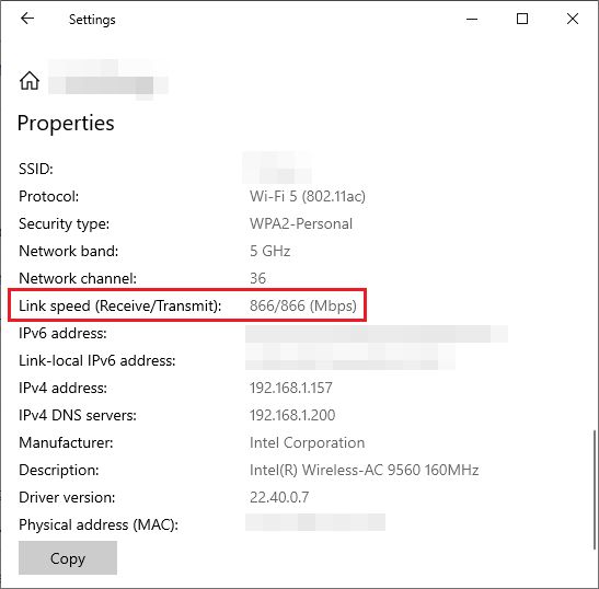

It is possible to test speeds pre-upgrade by having something conected wirelessly to one of your Complete Wi-Fi discs and something connected to the hub (preferably wired) and testing the speed of a file transfer between the two devices.
There are tools like iPerf that can be used to do this but I'd only recommend it if you're technically proficient; it is far from straight forward.
Depending on what Wi-Fi devices you're currently using, you can probably see the physical rate they are conecting at by looking at the Wi-Fi properties. e.g. on a Windows 10 machine, you can left click the Wi-Fi connection icon in the system tray, click 'Properties' for your active connection and then scroll down to 'Link speed (Receive/Transmit)'. Likewise on Android smartphones etc. you can go into the Wi-Fi settings for your active conection and it will display the Transmit and Receive link rates: -
Note that these values are significantly higher than what you will see in terms of actual throughput/real-life speeds. It's not an exact science, but a good start is to pretty much halve it.
e.g. here is a speedtest I've just carried out using the same machine I took the above screenshot from. The actual speed I'm getting is ~440Mbps versus the 866Mbps receive link speed shown by Windows: -

Another thing to bear in mind is that today's Wi-Fi at the higher gigabit FTTP speeds is almost always constrained by the capability of the connecting devices, not just the capability of the hub/discs. You need to consider this if you are thinking about upgrading your equipment as changing the hub is only half of the eqution. e.g. upgrading to a Wi-Fi 6E hub/mesh is all well and good, but if none of the devices you own support 6GHz Wi-Fi then it's unlikely to make jot of difference.
