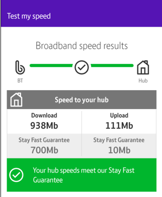

Thanks for your reply. Yes we meet stay fast guarantee and our upload speeds are fine but we are lucky to get 50mb on a device the max is 130mb on a good day. Our speeds were faster on the old broadband to our devices. All is set up correctly and a new hub all done by an engineer 10 days ago just to be absolutely sure. No one seeks to know why
It sounds like your broadband is running at the expected speed, but the problem is with your in-home WiFi.
You could verify this by testing speed on a device connected to the Hub by an ethernet cable (Cat 5e or better) - you should get close to the package speed.
If the problem is your WiFi then you could try a number of things:
- run ethernet cables to any fixed devices (PCs, TVs atc.), so that WiFi is only used by those devices that really need it
- download a WiFi analyser app to your phone, use this to find the least-busy channels, and switch your hub to one of those
- set up a WiFi mesh network - BT offer two versions, or you can go for a 3rd party (e.g. Deco or Eero, or one of many others)
- run ethernet cables to remote parts of the house and connect WiFi Access Points (APs) to those to provide WiFi connectivity at those points.
