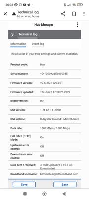

Hi @imjolly thanks for replying, yes I tried changing them manually, the router settings on that screen shot was after I had tried doing a hard reset so it changed everything back to factory settings.
Currently 2.4ghz is on channel 6 and 5ghz is on 48 as those were the least congested.
