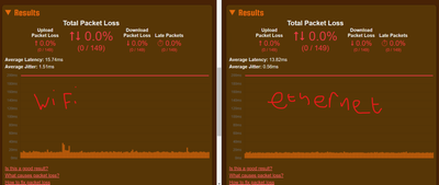

The absolute best you can do to eliminate high ping/packet loss (aka lag) caused by equipment in your home is use an ethernet cable. The fact that turning of the smart connect feature helped means that the devices in question were downgrading to the 2.4Ghz network in order to try and get a more stable connection.  The more devices on wifi, the more the problem is compounded. For reference, in my property i have installed Cat6e to every device that is not mobile so the only devices using my wifi network are phones and tablets. Even when they negotiate a 160 Mhz 5Ghz band, you will still see a high "jitter" and experience some packet loss due to interference from neighbours routers - and im using the unusual DFS channels.
For reference, i have included a screenshot of a packet loss test that includes a ping measurement. One is on a 1Gbe connection, one is on a Wifi6, 5Ghz 160Mhz channel, with a negotiated speed of 2162/1922 (Mbps) , basically the best case for wifi - notice those ping spike on the wifi, even in a best case scenario. That can cause the "lag" you feel
Tl;Dr Want no lag? get a cable between the router and the device you want no lag on. If you still have lag, there's an issue with the connection to your home (verify by running https://packetlosstest.com/ on uk server with hardwired connection), or the game server you are using.

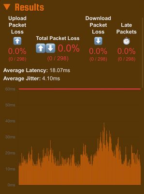

This was with uk server selected and to fornite as an example although the issue I have is with FC24  

Try to get a result on a hardwired device if possible - your result very much looks like wifi. It should be a relatively flat line, with the Average Latency no higher than 25ms and Average jitter below 1ms.
