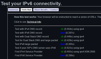

The O-bit ios now ticked.
Tried both PPP & DHCPV6, but still the same results:
PS: Not using the phone anyway, so no impact from DV => Using the Draytrek as modem.
FailOver from USB 4G modem (deactivated for the tests).
IPv4 works perfect
IPv6 seems to be working on WAN, but failing on LAN. Sadly my IPv6 knowledge is poor.
Should my laptop get a fd46:[...] IPv6 address or this is already a symptom of the problem?
