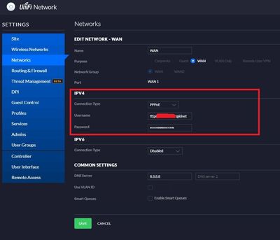

I'm currently with the ISP IDNet for Fibre-To-The-Premise (FTTP) and am shortly moving to BT Fibre FTTP, specifically Full Fibre 300.
Currently I connect the Enternet port from the white BT Openreach device, to the WAN port of the USG model 3P and then have configured a PPPoE username and password in the WAN network in my Unifi management console (see screen shot below).
Can I use BT Fibre 3000 without the supplied BT Smart Hub?
Is it simply a case of using my BT username and password in place of the current IDNet one?
Where do I find my BT PPoE username and password?
I'm hoping it is as simple as that, but would appreciate guidance on the questions.

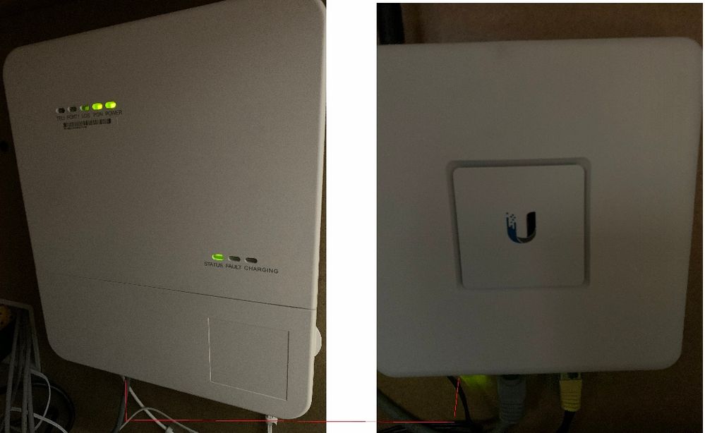

Here is my BT Openreach Box, connected the USG WAN port via an Ethernet cable.
Yes
Yes
It is generic. username is [email protected] and password BT

Thank you licquorice. I had done some research and thought it would probably be OK, but last thing I wanted to happen was to get BT switched on and find I was searching around to get it working 🙂
Looks like the username and password are generic for all customers but I guess that is OK as it will only work to provide a connection via an FTTP connection for a specific device/line.
I'm enabled on Monday so hopefully all with be smooth enablement.

I have the same setup as in your picture. Didnt know it was called BT Openreach Box.

@roslionIt's not called an BT Openreach box. It's an Openreach ONT.
