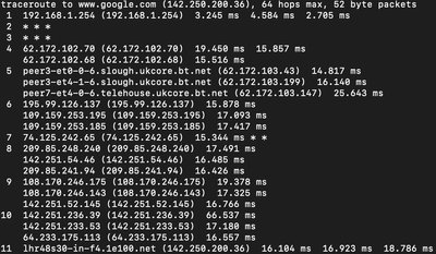

I think this came up recently on another thread, but that doesn't seem to be consistently the case - there's no 172.x.y.z in any of my traceroutes (unless they're hops 2 or 3 which aren't responding?)

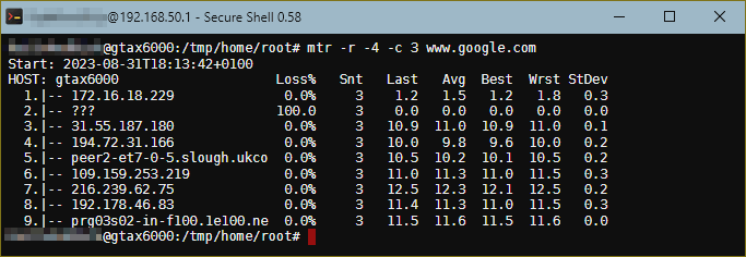

Hate to say it, but here's my trace route to www.google.com
And it's clearly routing through 172.16.18.229!  So 172.16.x.x is potentially a problem.
