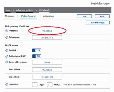

The trick is not to let the HH2 squat on its preferred IP address for your network. That is likely to clash with any other router that you buy. They all like to use the same IP defaults.
Here's what I did with the local IP address:
Then I connected my Netgear router and let it connect to the HH2 to see what IP address the HH2 assigned to it:

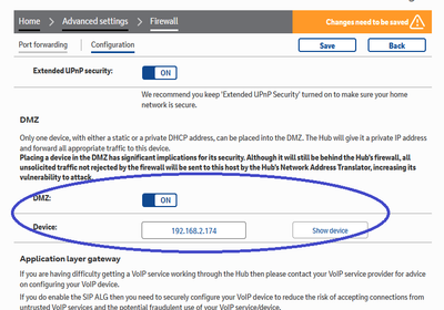

Then into the Firewall Configuration of the HH2. Turn on the DMZ and insert the router's IP address there.
The Netgear router should be on its own default IP address 192.168.1.1.
You can use a browser to get to that address and manage the router. You can get into the HH2 on its IP address, the one you gave it.
