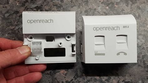

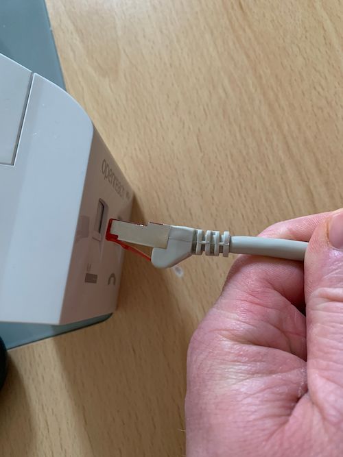

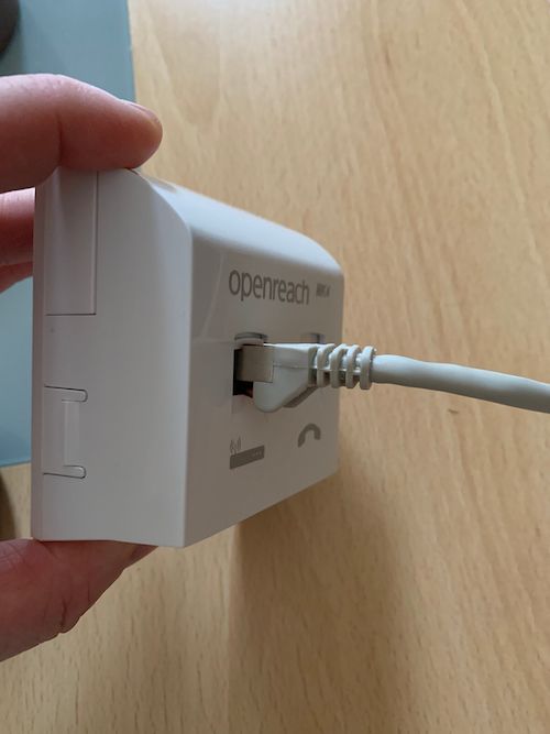

Hello,
To be exact, the ports of the MK4 Faceplate on the Master Socket 5C are: on the right, a BT Telephone Socket and on the left an RJ45 socket that also takes an RJ11 plug. It is not an 'Ethernet Port' as it does not actually accept Ethernet Frames and is not connected to an Ethernet Network, but the socket itself is dual.
(I, myself, had fitted an RJ45 plug to my DSL lead (RJ11 one end to the router, RJ45 to the socket) because as I was redecorating the router fell and the lead stretched to breaking point — and the only plugs I had to hand to replace were RJ45's.)
I have since removed the MK4 and replaced it with a plain BT Plug faceplate and re-crimped the cable with a BT431A end as I have FTTC and digital voice and so a filter faceplate is no longer needed… but that's a bit off topic.

For FTTC only the left hand socket is used for VDSL and fits in exactly the same port in the back of the Smart Hub as ADSL - the small grey RJ11 port.
You should have, ADSL or VDSL (if you are not using a later Master Socket 5C) a DSL filter dongle. Not just on your phones. The dongle plugs in BT connection to the Master Socket, provides RJ11 for Internet and Phone for normal PSTN phone. If you are not using a filter between Master Socket and router, you should be. And that might be the confusion. I think you are. So a filter is needed there and an RJ11 to RJ11 connection between that and the Smart Hub router (supplied with the Smart Hub).
If your socket was upgrade to the Master Socket 5C as above, the filter 'is' the MK4 faceplate, and the separate ports are presented within it.
