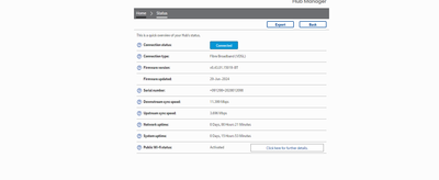

Can you post a screenshot of the Hub page that shows the connection details?
 Is this the screen you mean? The lowest possible guaranteed download speed offered by BT in my area is 35mb, so surely something is wrong?

Yes  that shows the Network uptime as only 21mins which unless you have unplugged the line is indicative of a problem and the down link speed as only  11.4 Mb/s up link as 3.7 Mb/s. I would definitely log a problem with BT as it suggests there is a fault somewhere.
