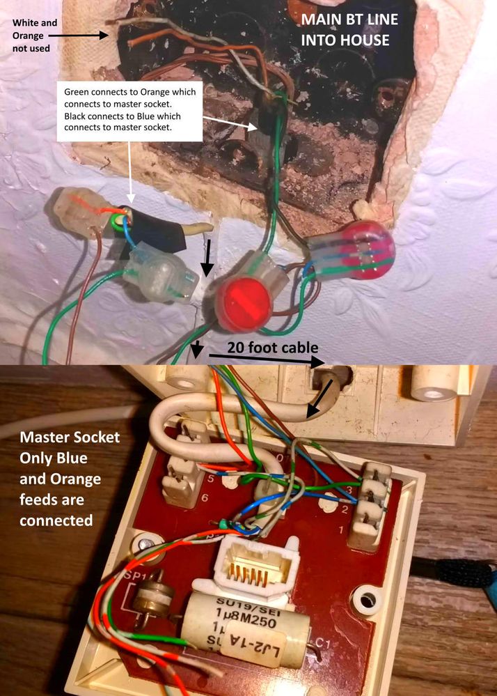

Partners house (late 60's early 70's) main BT cable has the normal Black, Green. White, Orange wires.
BUT only the black and green wires are used, they go to the master socket. Everything works though.
( I noted that my house is the opposite only white and orange are used straight into a modern Openreach socket to A and B terminals).
The master socket in partners house has to be re-positioned (currently it is a good 20 feet away from the cable entry point) to an Openreach socket to A and B terminals with phone and DSL outputs.
Is this likely a simple case of the wiring being 'wrong' on original installation?
I enclose photo of the inlet cable and the socket it wires to 20 feet away.
The question is which wires connect to A and B on Openreach socket?
Cheers
Jerry

The incoming connection only requires 2 wires. The orange and white wires are pair one at green and black pair two. Normally pair one would be used but if it was faulty pair two would be used.
All wired correctly.

Thanks,
Black to A, Green to B?

@JerryUK57 wrote:
Thanks,
It doesn't matter, broadband and phone are not polarity conscious.
