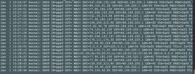

Everything works as expected. BTHub, Laptop and MESH. My only concern is the high level of dropped packets, as measured on the ASUS router and the external think broadband monitor. I am linking the two together to the loss of internet connections and speech/video dropouts when connected when streaming.
I know packet loss is normal, but at these volumes could this be the cause. It is difficult to explain to BT and Openreach that the problem is intermittent, and all speed tests look normal.
Screen shot of ASUS log below is this normal or does it indicate a problem?
