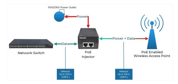

Google POE injector, they're generally around £25 - £30

you'll have to explain what an injector is.
In your case replace the Network Switch with your Hub & the single port injector with a dual. If you intend adding other POE devices then a POE switch would be better.
