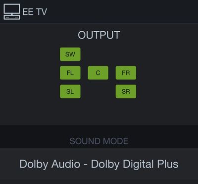

As far as I know the EETV Box Pro always outputs in DD+ when in surround mode, so regardless of whether the source is stereo, multichannel, atmos or whatever,  your AVR will say DD+, thats what my Denon AVFORGOTMODELNUMBER says. However if I use my Apple TV Box then yes I can see Atmos pop up on my Receiver.
So indeed, whenever I watched TNT Sports Ultimate channel my AV just shows DD+. If you bring up the AVR OSD you can usually check what channels are actually active. For example on the Denon app if all channels are active:
If they are not all active just stereo (FRFL) will be in green but the sound mode will still say DD+. I have deduced from this that even if TNT Sports Ultimate via the EPG is presented in Atmos, my AV will still show DD+, like it does for any channel.

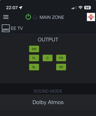

It’s actually really hard to explain mate and it’s mostly down to poor implementation of the audio on the EETV Box Pro where it doesn’t actually pass through the source audio and packages everything up in DD+, so your AVR wont switch to Stereo when watching BBCOne (which is definitely not DD+) and won’t switch to Multi Channel when watching Sky Sports (Which is not DD+), at the same time an AVR won’t then pickup when the Atmos is there on top of multi channel. ATMOS when delivered via the DD+ is lossy, when delivered with TrueHD it’s lossless, the latter seems to be picked up without fail on AVR’s.
Lets get this out the way….yes it’s possible, here’s me watching a recording of City vs Sparta Prague:
It’s problematic more for AVR’s, as far as I remember you use eARC assuming the TV passes audio through to the sound bar. Probably works better that way with EETV.
The OP might be able to use ATMOS on his AVR if he manually changes the audio mode when he knows ATMOS is there, it’s possible for me. But it’s largely pointless if you don’t have the relevant atmos speakers so might as well just stick with the DD+ for all channels which offers the best audio sync.
