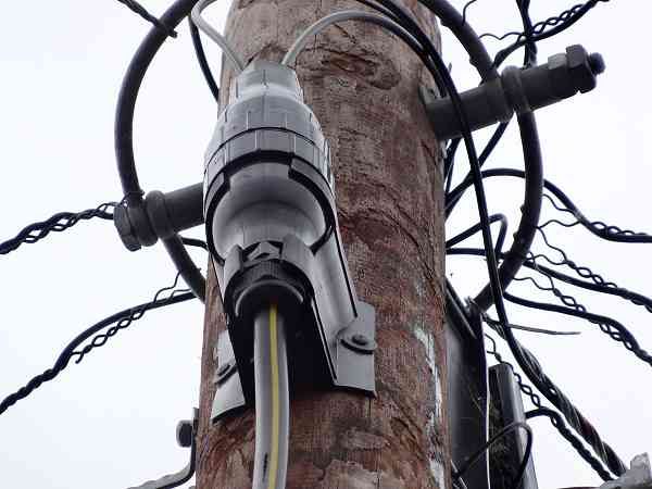

Wall Box with bare outer cable
Fibre Manifold - My Cable coming our right, top
