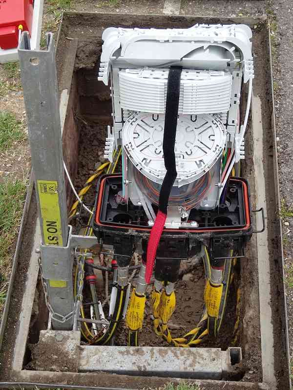

Wall Box with bare outer cable
Fibre Manifold - My Cable coming our right, top
Aggregator Node with Fibre Trays
Mini Compressor for blowing the fibre 200m away to my house
Out pops the fibre... split into four, 3 cut one remained
Fibre Splice Box Done - next step in 10 days
New Cable comes over teh road from the Fibre Manifold
Ready for the 2nd part
You can see that only one fibre is used, other three spare
Takes the coating off both sides so they can be fused
Special tool to give a true edge to each fibre
Fibre from road and fibre to inside of house ready to fuse
Fused in 15 seconds, 0.03dB attenuation on complete link to exchange, perfect
Fuse a protective sheath over the join
Tuck it all away outside
All connected (telephone to be enabled later)
