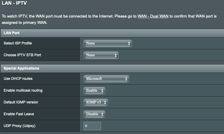

Typically tis could be down to the IPTV settings.
This screen shot is from my DSL-AC68U so maybe just a little different to yours:-
Hope this might help.

Thanks Tim. I had found this on the interns but unfortunately the AC86U interface is slightly different. I don't know if that makes a difference.

Have you tried changing the default IGMP version?

To whatever other options are available in that box. IGMP snooping is what is required for multicast operation.
