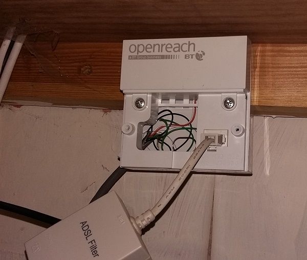

I took the whole  face plate off the socket and there are no other sockets behind the one I've plugged into.
If I unscrew the socket I'm plugged into now, it's just wires.
There is an engineer appointment now booked for Monday but I don't know why I keep having to report the fault when they detect a problem with their network each time I report it and I get no useful updates on the fault tracker.
I'll leave it plugged in like this for a few hours and see if I notice a difference.
Regards

you have removed the front and middle section at same time and left the main section shown by black arrow

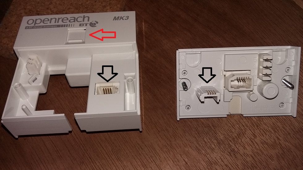

socket 1.jpgSocket 3.jpgThe 2 parts shown on the lower photo screw together and then that screws into the bit stuck on the wall.
The black arrow on the left plate plugs into the 'test socket' shown in the top picture.
The black arrow on the right plate plugs into the left plate and feeds the phone and broadband socket. ( Red arrow )
The filter is all built in.
your picture shows an extra separate part that this socket doesn't have.
My phone and Broadband plug directly into the socket as shown and it doesn't come apart any further.
To eliminate all that  I assume the separate filter needs to be plugged directly into the wall socket in the top picture. ?
Or do you want me to screw the left plate back on to the wall and plug into that ?
Regards

no what you have done is fine
your photo with just black arrow is same as mine with red arrow  the middle section shown by your red/black arrow is same as my yellow arrow
the test socket is shown by my black arrow - your black arrows do not show the test socket
