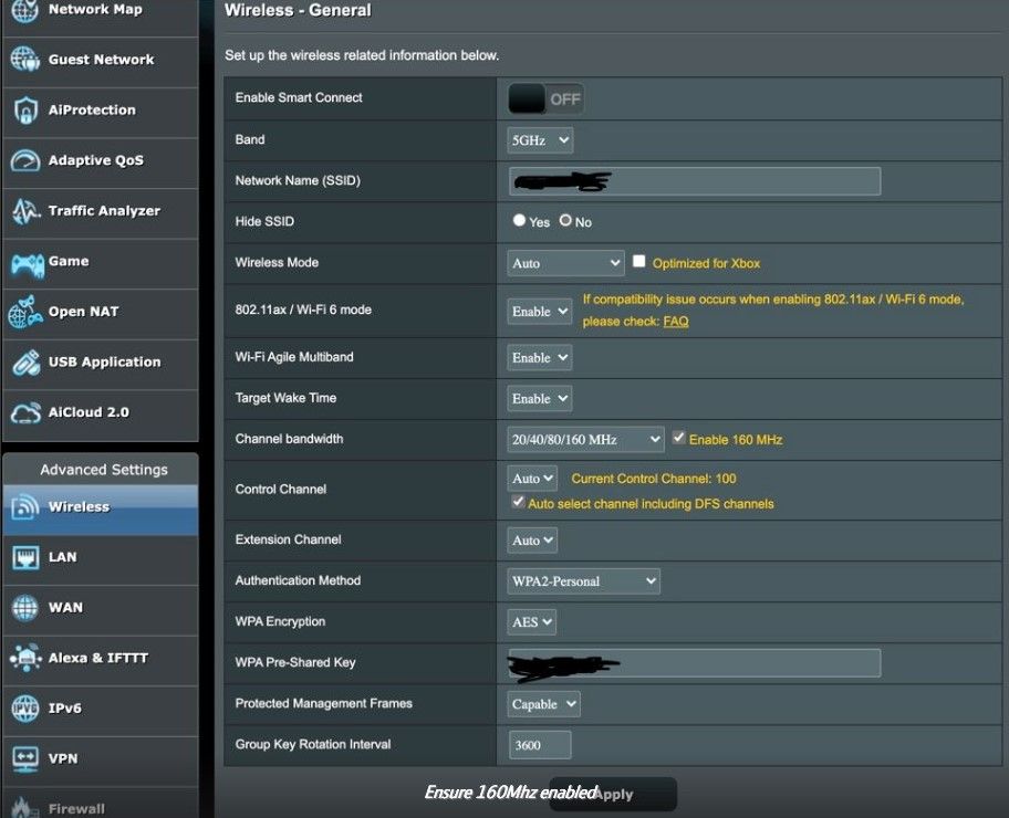

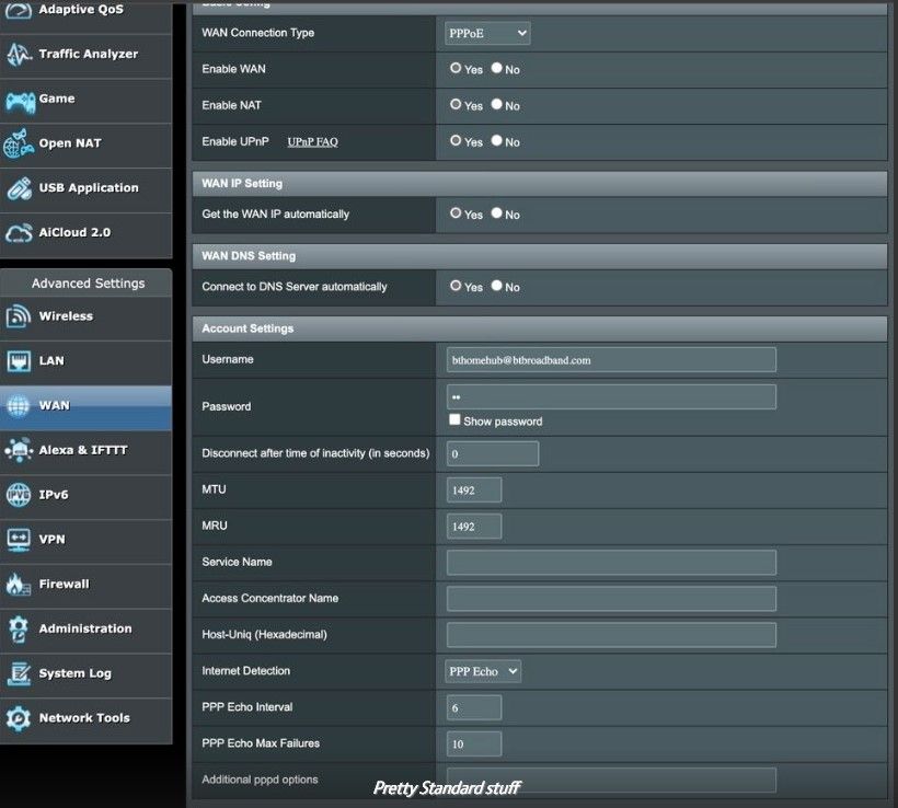

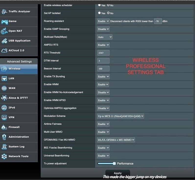

Tom there must be underlying problems if that isn't working properly.
These are the settings I used kindly sent by jedpause.

 It needed firmware update and these settings, thanks
Speed on the macbook Pro came to over  700 + mbps , usual 400 on the bt sh2     speed on iphone 12 pro came in at 600 wirelessly which is a lot better to be fair  roughly 300 on the SH 2
much appreciated
