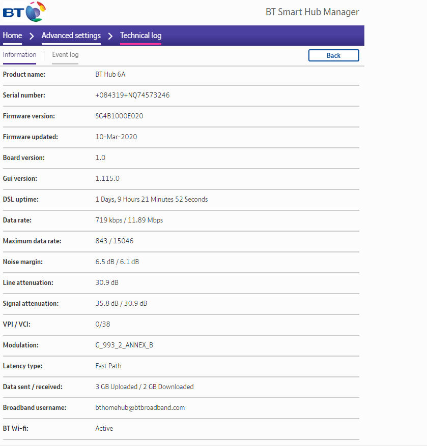

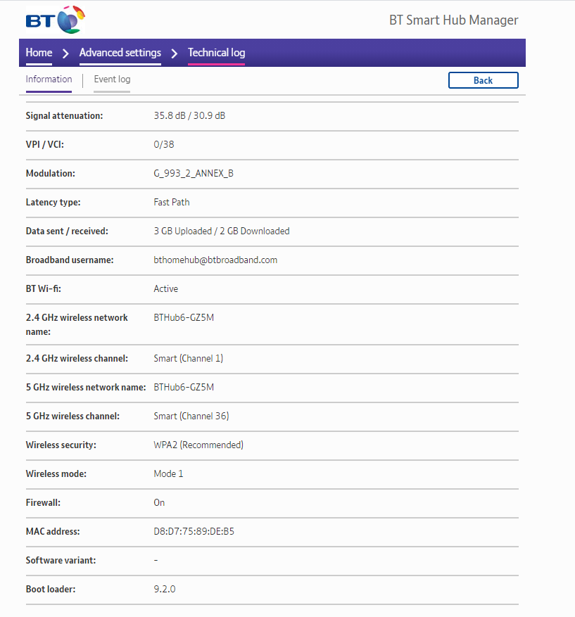

So when someone says im on fibre i expect high speed broadband, im at a point where i can really only move providers to Virgin Media, but dont understand why half of my postcode has been done to the new full fibre but my street still cant get above 11mbps.  Ive attached my stats from my router and bt tech support said there is nothing more we can do.  Any thoughts.

Enter your phone number and post results. With your attenuation you are a long way from your street cab

@imjolly Thanks for your speedy reply
Ok so would that explain why i get a lot of drops in performance like download speeds in file downloads and just not great performance even when wired into the router not on wireless.

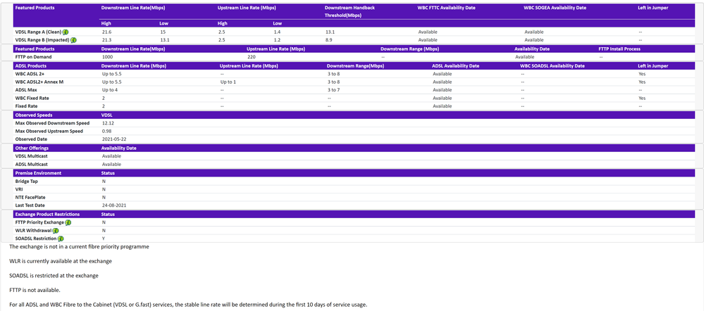

Are you having problems with your hub dropping Internet connection?  Often?
Have you tried connecting to the test socket with a filter to see if that improves your connection speed and stability?
