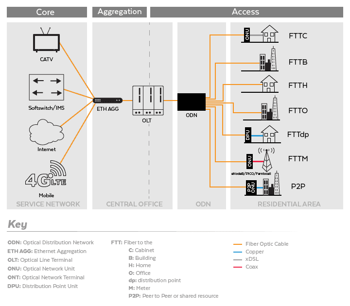

It is not FTTdp, that is the equivalent of FTTC where instead of the DSLAM is at the DP rather than the cabinet and the broadband is still delivered by copper rather than fibre to the house.
What you have is an optical feed delivered from a CBT (connectorised block terminal) which is the fibre equivalent of a copper DP entirely different to FTTdp.
8,123 Views

Accept what you like, it is fact not opinion. The clue is in the name FTTdp (fibre to the dp) which is where the fibre ceases and becomes copper. You are getting FTTP (fibre to the premises) where the fibre extends to your house. It is being fed from a CBT (connectorised block terminal) which both of you are mistakenly calling FTTdp.
Couldn't be bothered to look further for a better diagram, notice copper from FTTdp node to house.
