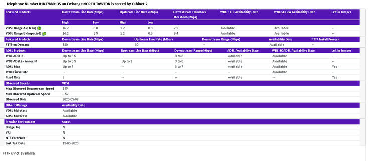

I have above the DSL rating it took for ever and the BT speed test doesnt load. At best in the past we get about 6mb p/sec last night it showed 3mb but thats when its fast.

Your data rate is below your handback threshold but noise margin isn't high. Definitely needs engineer visit to resolve.

Hi many thanks for your advise, although ive had 2 engineers out in the past year...
BT never refund any money for the poor performance. They do an online test when i phone and sometimes they say is 6mb mid day and thats enough or they just say we'll get an engineer out... The last one never turned up for the appointment.
BT engineers those that arrived, just check the line and then dissapear.
Is there a simplified version of whats likely to be happening. Is it the line itself, junction or server issue that needs looking at, so i can least guide them to where to look.
The help is much appreciated, hopefully something will come of it.

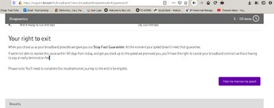

Got this far and guess what BT Crashed Again, so I couldnt book an engineer 😡 and it didnt log the tests completed (no surprise there) does anything on BT work !
I'll have to go through it again and hopefully at some point BT will recognize they are not supply service fit for use.
