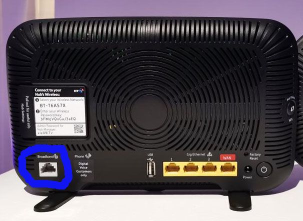

I think you will find that both versions have an RJ11 socket at the back,
Apparently not

Yeah, my hub has the smaller RJ11 connection where you have the blue circle.
