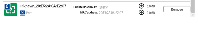

Hi @licquorice ,
Different SSIDs assigned but still same issue. The Netgear router is listed on the SH2 as;
Does this look right at the SH2 end? I was expecting to see the IP address I've assigned to the Netgear router there?

Go to solution
The SH2 network map is a complete dogs breakfast and can't be relied upon for accurate information.
