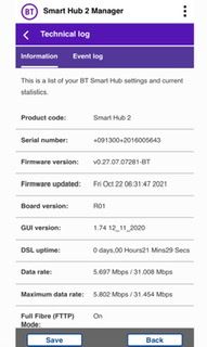

sorry the stats looking for is by going to hub manager then advanced settings then technical log information  what you posted are basic connection speed
4,449 Views
Message 12 of 25
Re: BT Speed vs competitors
Go to solution
@imjolly  is this it?
These are the speeds I’m getting, therefore is this the max regardless of provider? Therefore why does BT wholesale say much higher too? Dear me I’m confused. 

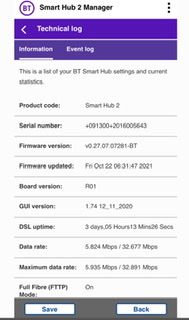

@iniltous  @imjolly  I’ve ran the test again and plugged into the socket as explained. Here are the results. Any idea what to do next?
BT are being less than helpful when I call and explain that as a new customer it shows far higher than I actually get and just say it is what it is. 
