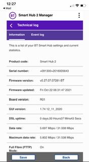

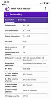

at present with your 31mb connection you are right on the stayfast figure and unlikely BT will help
it appears you have a poor line and moving ISP whatever they quote as expected range will be no better than you currently get as use openreach network
what noise margin is shown in stats as you have cut of some of the bottom stats

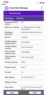

@imjolly  @iniltous  Here is the full page in 3 pictures.
As you say right now I’m dead on the guarantee at 31mb but to renew my contract as they want me to they’re lowering the guarantee to just 25mb meaning I’m even worse off whereas the other provider are offering me a guarantee of 39mb. It all just seems nonsense to me that BT won’t help and are effectively pushing me to the new provider.
