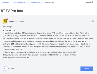

Further to my own post about the Surround Sound implementation on the new BT TV Pro box, here is another person asking about this on the Sony community site.

HS6
That was me who posted on Sony I have also posted on this forum earlier on and as you say this box is awful and a backward step. I have even had 2 engineers to the house who really did not have a clue on what to do as they have had very little training on the new box, one even advised to replace it with the old one. I tried but BT were reluctant to do this. I feel trapped now in a 24 month contract. I like to watch sport and they advertise BT ultimate with a "immersive sound experience" which I do not get as if I have it in surround then the sub goes to sleep and the sound is flat. I find there advertising misleading and I have asked the question on here before "what systems did they test this box on?" but as you can guess no reply. As you say you can never get past the "techs" on the phone who have limited knowledge and basically seem to work of cue cards. Disappointed isn't a strong enough word to explain how I feel.
