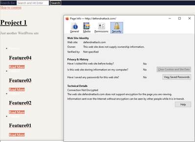

Agree with @jac_95  advice, also look at your SSL certificate, Firefox and Edge flag it as an issue.
Is it self certified ?you can get them for very little these days.

@-Richie-  looks like there's no redirect from http to https which is why you see a certificate error as it's not using the secured connection. Can be configured at webserver or ALB level

@jac_95  Good spot, manually entering the HTTPS works, without it gets flagged as insecure.
