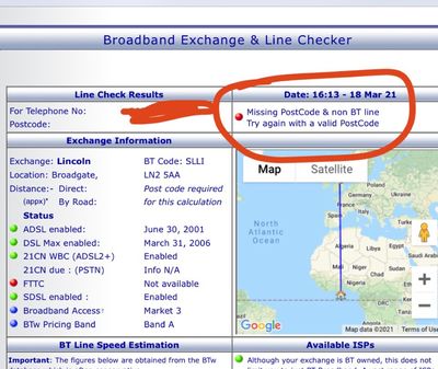

I wonder if the number you are entering was used at a previous location with BT and is now used with Plusnet at current location but old information is still held on the checker database. The last speed measured on the line was 29/9/2019 from your screenshot.

I attach a screenshot below. Not sure if it means much though. The map is also not correct but presumably that’s because I’ve not put the address in.

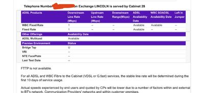

out of interest I thought that I would put the phone number through the DSL checker again. It’s now coming up saying it’s connected to cab 28 and by the looks of the results any form of internet is basically non existent. Here is a screenshot
What could the reason for this be? Does it suggest that the results on this number through this checker are not making any sense? Last week said connected direct to the exchange and this week saying connected to cab 28. Can either of you tell me where that cab is?
or could it be that the previous occupier took her number with her hence it now says it’s connected to cab 28? I can check with her although we only completed yesterday so could it have updated as soon as today?
I also spoke to my neighbor today. It’s a semi detached house. She confirmed 100% that she has fibre.
I guess in reality I just need to be patient and wait until I have control of the line but just wondered if the different DSL result gave you guys any more thoughts on the issue? My hope is it’s proof that the  results for some reason on this line are unrealisable but maybe it’s as simple as she has moved the number with her. Is cab 28 FTTC enabled? I know where she has moved to and it’s still right in the city centre so those results look dreadful in terms of speed.

The only logical conclusion is that the previous owner took their number with them and that is the result for the new property, although it does seem rather quick. Definitely something odd with the number.

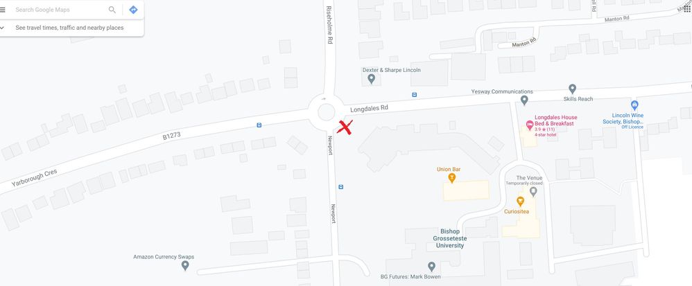

Cab 28 is here
