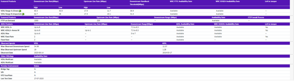

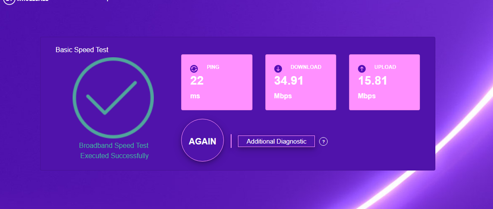

Broadband checker+BT speed results

your connection time is only 11hrs is that due to hub dropping connection or manual reset?
any noise on quiet line test?
have you been having problems with hub dropping internet connection? often? or have you alos been resetting hub to see if you can improve connection speed
I think you are now in banded profile due to line instability and you now need to get a stable connection before you will see any improvement in connection speed and therefore download speed
