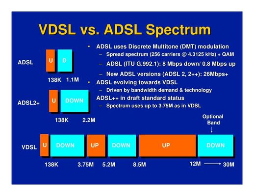

The upload portion of the bandwidth is mainly located at the higher frequencies, which unfortunately are the first to be affected by crosstalk.  You may like to try disconnecting your line for a minute, and seeing if it will reconnect at a better speed.
The only solution is to hope for an FTTP connection in the future.
