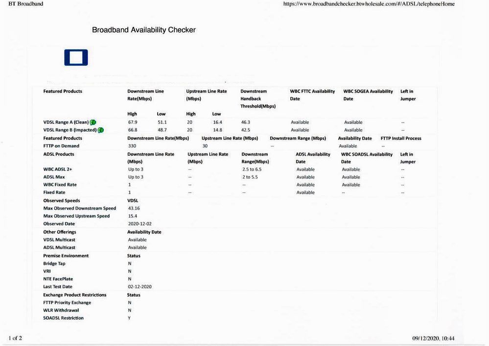

A year ago my Broadband download speed was constantly above 65 Mbps. I have a Draytek Modem and Netgear Orbi Router and Satellite which is still the same. In the last 6 months or so my download speed has hovered around the 43 Mbps guaranteed minimum and often below 40Mbps. The last week its been 39Mbps. When I run a test through MyBT in order to report it I always get a 'Sorry we are unable to test your speed' and this has happened for months so I guess its because I am not using a BT Router?
I regularly test my speed using the BT Wholesale Test site and today I get Ping 74ms  Download 39.62Mbps Upload 15.73Mbps. I am really getting fed up with paying for something I am not getting and am seriously thinking of going to Sky or Virgin.
Anyone have similar issues and have an answer?

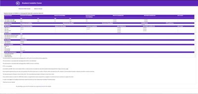

Just to add to the above I get the below results

Have you connected a ( preferably wired not cordless ) phone into the test port of the master socket and checked for noise ( 17070 and quiet line option ) ?
Have you still got your BT supplied router, perhaps you can reconnect that into the master test port and post the connection statistics, the image you have posted for the predicted speeds is poor ( well I cannot read it anyway ) can you repost it at a better resolution, if it’s you do remember to remove your phone number

Image 09-12-2020 at 09.46.jpgImage 09-12-2020 at 09.46.jpgI have checked the quiet line and its perfect. I dont have my old router am afraid. will repost the screenshot

I still have problems reading the dslchecker when I magnify it just blurs
can you post stats from the draytek modem

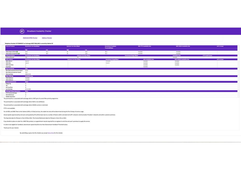

Is this better?

Re: Broadband Speed Slow
Much better. Now can you post the connection stats from the draytek.
