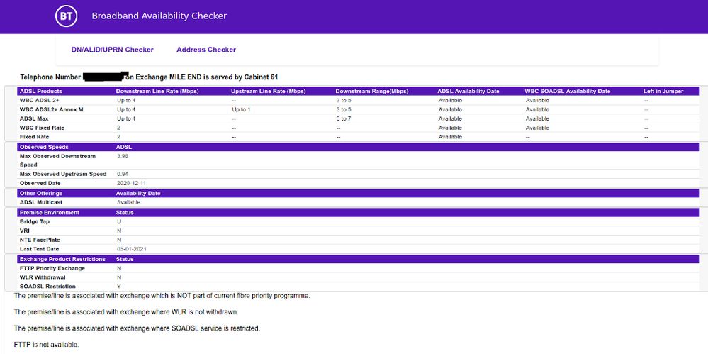

Exchange & cabinet no. given here -
5,420 Views
Message 6 of 35
Re: Cabinets that don't have fibre - where does it come from?
confirms there is no fibre connection available to you and no date for any upgrade
