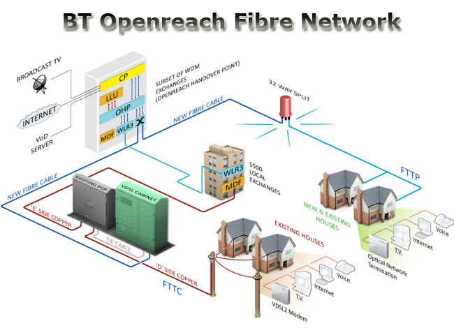

This shows how.

I think I'm mixing up FTTC and FTTP. Am I correct in thinking that FTTC is a hybrid which consists of a fibre connection to an existing street cabinet & then use of the existing copper cable to the premises?
Are you saying that FTTP bypasses this altogether and simply makes a connection from a local serving node directly to the premises?
Does a serving node look like some other kind of cabinet on street level?
3,678 Views
Message 19 of 35
Re: Cabinets that don't have fibre - where does it come from?
See the diagram I posted. By serving node I mean the exchange containing the optical headend (OLT). The 32 way splitter is just an enclosure mounted on either a pole in overhead distribution areas or in joint box (manhole) in underground distribution areas.
