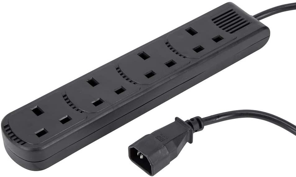

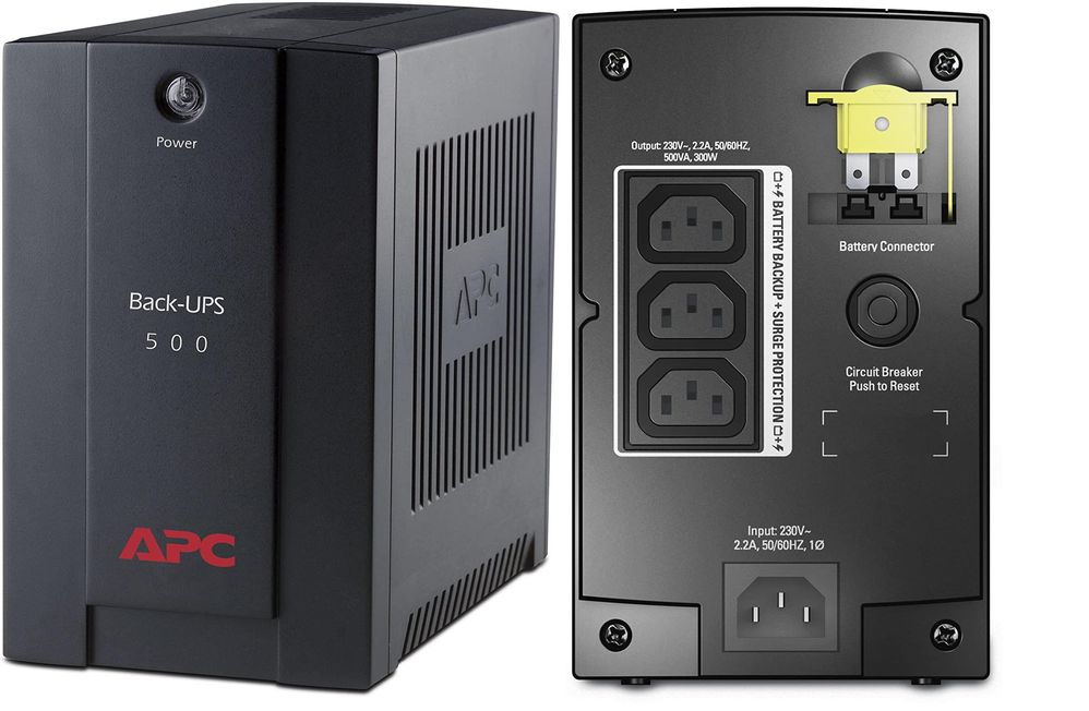

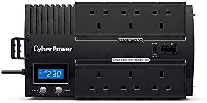

That specific UPS style claiming to be designed for BT 12v equipment is a terrible idea because what happens when the unit (UPS) fails after a few years (as it surely will when the 19th century lead acid technology battery gives up the ghost) or there's a new SmartHub socket style? It's essentially forcing people into a proprietary system which is not needed. We're going down the 'gold' SCART cable route.
The whole idea of the UPS is it's needed immediately  so messing around looking for an exact replacement -or not- is silly.
Just buy a standard UPS it's dirt cheap and totally universal to any 13AMP style plug (OK, you might need to add a fly lead but it'll be OK for the next 100 years).
Good alternatives:
CyberPower BR1200ELCD-UK
Or the style where you'd need a fly lead:
APC by Schneider Electric Back-UPS BX500CI
...and you'll need:

Manufacturers' literature for the two UPS units described above show that they both use sealed lead-acid batteries.
The CyberPower unit's runtime chart extends down to a load of 60 Watts, for which a runtime of 80 minutes is claimed.   How much longer it would run with the much lighter load imposed by a Smart Hub2 (about 9 Watts when idling) remains to be seen.

Re: Digital voice and power cuts.
At lower power levels, I would expect that the internal circuitry of the UPS would be using more power than the home hub, so there may not be much increase in runtime.
