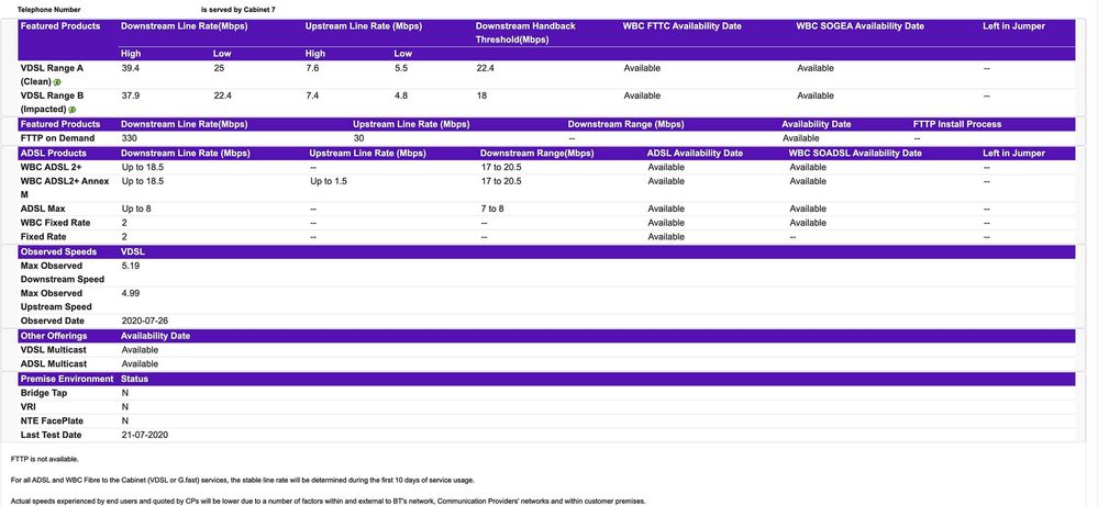

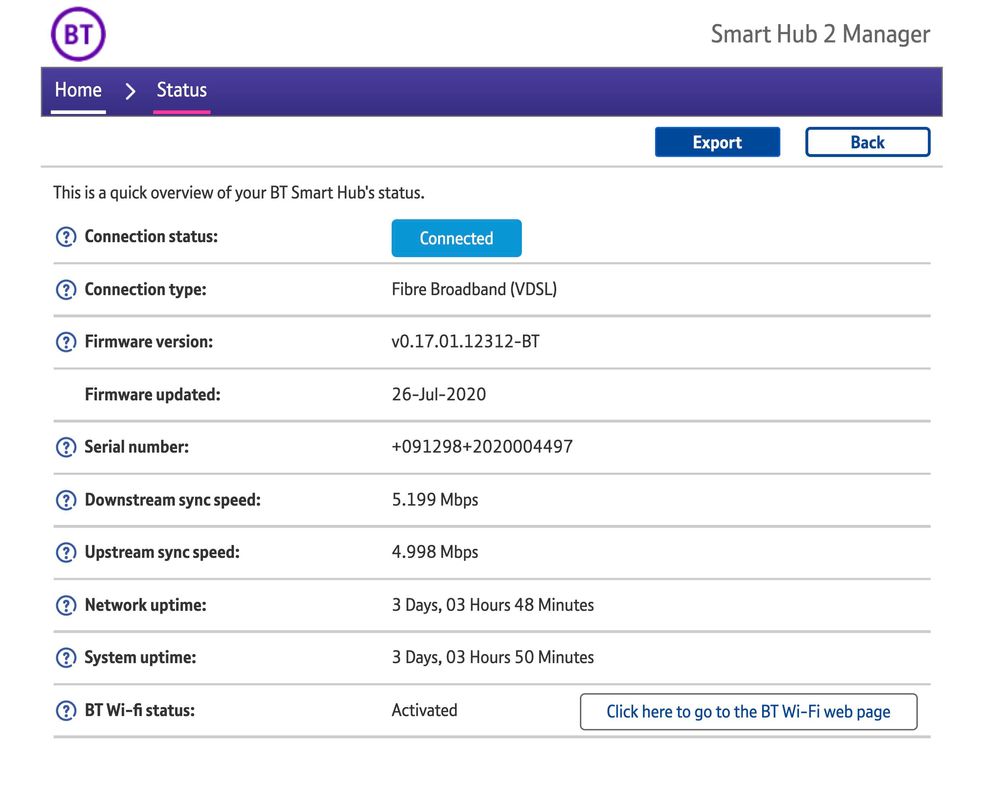

I am having a problems with my broadband being very slow. My router was having to be restarted everyday as it wasn't working properly, I got onto BT as my account was due for upgrade and they renewed my contract and sent me a new router out which is a smart hub 2. According to my account details my estimated download speed is between 20-36mbps and my Stay Fast Guarantee speed is: 17Mbps.
The router has been plugged in and connected for three days now and my Downstream sync speed seems to be stuck at 5.199 Mbps and my Upstream sync speed is 4.988mbps so I do seem to be having a slow connection speed.
I have attached a screenshot from my router status page and the result I got from doing a broadband speed test.
It is a long time since I have done a speedtest but I used to get around 24-25mbps when my original Homehub 5 was working properly.
Does my account need resetting or is there something I can do myself to get the speed back to what it used to be please?
Screenshot 2020-07-29 at 17.43.47_copy.jpgScreenshot 2020-07-29 at 17.42.35_copy.jpg

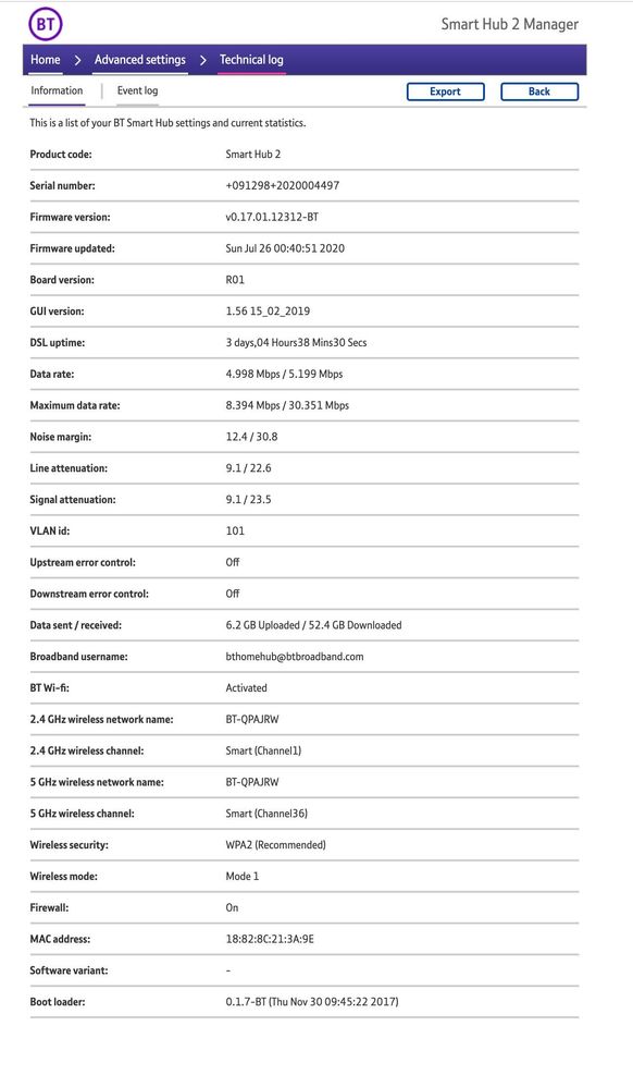

Can you post the router page that actually gives us useable information? Advanced settings/technical log/information.

Thanks for the reply, I have attached a copy of the page you have asked for and I've rang the quiet line test number from a corded phone, does that give you a reading on noise or is it just that you have to listen for it? I pressed option 2 and apart from her saying "quiet line test" I couldn't hear anything. If you need any more information please let me know.

I have attached the page you have asked for, I took the liberty of plugging the router into the test plug on the socket a couple of days ago as I remembered that I had been told that in the past. So all the readings are from the test socket.
