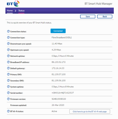

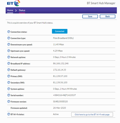

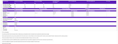

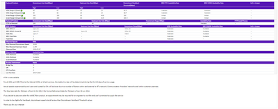

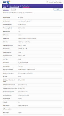

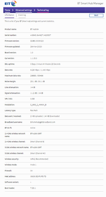

I have included images of my hubs stats along with the results from the bt broadband checker and it's much slower than it should be, anyone know any solutions?

Is your router normally connected in the master socket ?, if not try the router in the test port ( with a new filter if possible ) , post router stats to compare against the original stats you posted .

My router is usually in the master socket and I have now tested the router on the test socket and the results are virtually the same.

Has the hub been rebooting itself or have you been doing it in an attempt to improve the connection?
