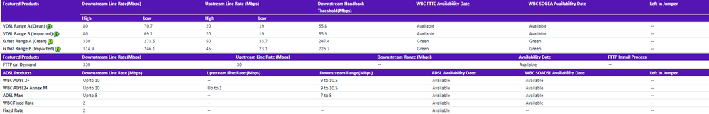

enter your phone number and post results  remember to delete number   https://www.broadbandchecker.btwholesale.com/#/ADSL

No problem, some more info -
Quiet line test absolutely fine, no problems there.

Which exchange and cab are you as you deleted that from your post?
have you tried using the test socket to see if that helps especially if you have extension sockets in other rooms

Exchange is STREET, Cabinet 6.
This may just be the best speeds I can expect, I was just hoping(!) for a bit more considering the cab is just around the corner...
Going straight into the new socket provided by Openreach when they replaced the copper line a couple of weeks ago (5C, MK4)
