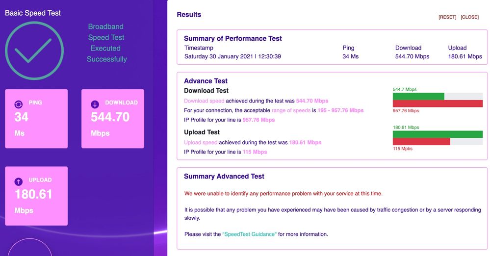

I (wrongly) thought there was a training period, like the olden' days, however I've struggled to get 600mbps down and this is plugged directly into ONT, brand new Macbook. Upload is absolutely fine, as you can see at 180mbps (amazing given its promised at 100). Wifi is even worse obviously, falling to ~350mbps.
So I've ruled out wifi, (by going to ONT), ruled out cabling (switched ethernets), ruled out line IP profile (see attached), ruled out router also (tried my Google Nest Wifi)

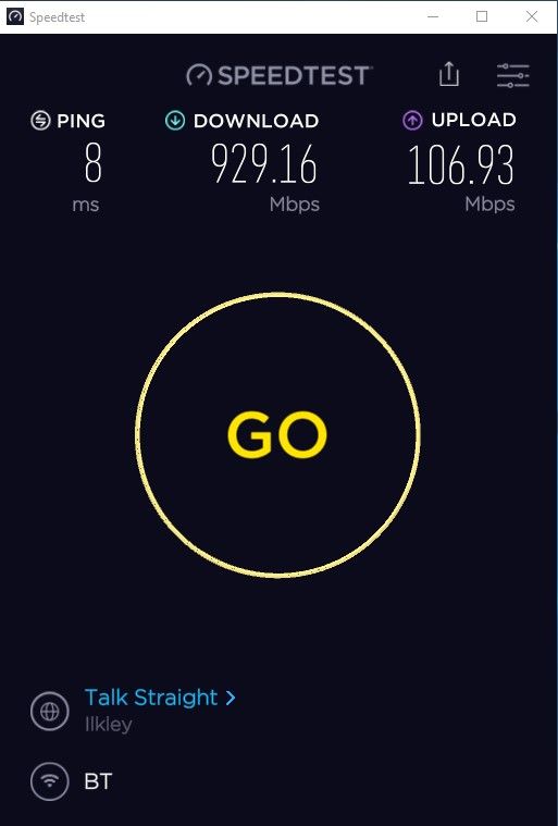

Upload at 180Mbps tells me the BT checker is not working correctly.
Looks like you're IP profile is giving the correct speeds so I suggest trying a different speed tester such as Ookla or similar.
I have the same package and get these results. Let us know what you get on the same checker.
Speedtest for your Mac or Windows PC

Hmm yep you’re right. Maybe a dodgy upload reading there.
Done again via Speedtest app via iPhone 12 Max, showing 466mbps down.
More normal looking upload at 104mbps. Ping 4ms.

Daft question - which checker was that screen grab from - I cant seem to see my results from the BT one here : https://www.bt.com/help/home/broadband/speedtest/?s_cid=con_FURL_hh6speedtest it just says its ok and past the 450mb guarantee...! (I dont mean speedtest.net, the BT looking one)
4,929 Views
Message 7 of 13
Re: FTTP 900; download way under, upload fine...
Go to solution
The BT speed checker looks like the BT wholesale one (https://speedtest.btwholesale.com).
If so, I found it to be highly inaccurate with the higher speed fibre packages.
Agree with the other post about using Ookla (you might have to try a couple of different test servers, as some cannot handle the speeds and therefore won't max out your 900 connection). Also could try fast.com, which uses Netflix servers.
Obviously, test with a PC or Mac and plugged in directly with ethernet cable and turn off the wifi on that device before running the test because any test over wifi will be subject to the usual wifi limits.
Your test on iPhone will almost certainly not be able to max out due to wifi constraints. Unless you have the latest and greatest wifi 6 everything, and even then, it's unlikely.

Hi Will, If you get the correct servers as you say I managed this which I can get regular now. 😎
___________________________________________________________________________________________
Say thanks by clicking the Thumbs Up icon. Have I resolved your issue? Click "Mark As Accepted Solution"
