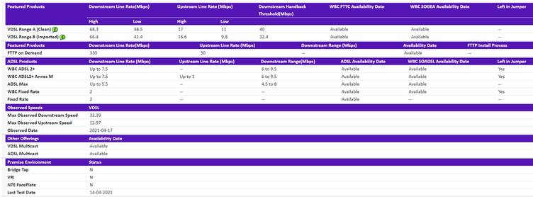

The BT Wholesale report for 01635 Newbury Cabinet 2 is as follows:
Assuming I understand this report correctly, the handback speed is 40Mbs, but the last observed speed was 33Mbs, does this perhaps suggest a problem?

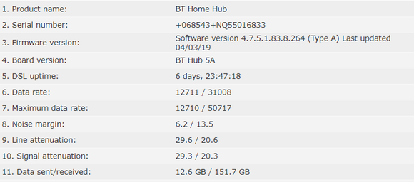

From looking at other community posts, I understand that the download speed is currently capped at 31Mbs but the line should be capable of 50Mbs. But again from reading the community, the download noise margin is perhaps a little on the high side and therefore limiting the download speed? I have tried the BT online fault finder with no faults found, and also used the quiet line test with no obvious problems. The HH5 is plugged directly into the BT socket and there are no internal line extensions.
Finally, I have been keeping a note of the WAN log since October 2020 and this is summarised below. The recorded dates mainly coincide with HH5 auto re-boots (although some are from manual re-boots when some devices have experienced connection problems). The noise margin seems to be fairly consistent on the upload, but the download noise margin varies from 8 to 13.9.

From looking at the WAN logs it is obvious that your connection speed problems is a result of your  connection instability which has caused the DLM to take action to try and stabilise your connection
You really need to find the reason for all your drops in connection as you need a stable connection for at least 4/6 weeks for your connection to improve
Bear in mind all speeds quoted hy BT are connection speeds to hub not download speeds at device

A brief update. On the 1st May I have connected the HH5 to the test socket using a new ADSL filter and new modem lead. The WAN log is still connecting at 31down, 13up with SNR 13.6down and 6.2up.
The HH5 has now been up for 4days23hours with no further WAN resets.

Unfortunately the HH5 experienced another WAN reset in the early hours of this morning (02:50 7th May).
Using the test socket with a new modem lead and ADSL filter the WAN log is now connecting at 31down, 12.8up with SNR 13.5down and 6.3up. (Basically unchanged from the previous log).
