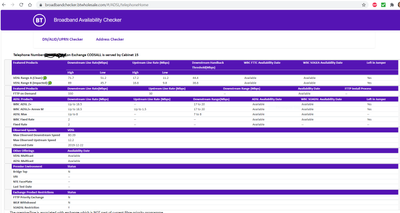

Certainly looks like your are on fibre 1 but from stats increase to fibre 2 would not be noticed in practice
Enter phone number and post results. Delete number but leave cab and exchange
https://www.broadbandchecker.btwholesale.com/#/ADSl
Stats don't look banded just fibre 1max

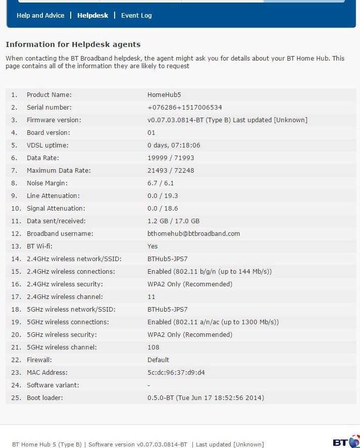

Stats as requested. There is minimal difference but we should get between 11Mbps and 12Mbps which makes quite a difference as our line is constrained by upload bandwidth, plus download usually ends up syncing around 60Mbps at 3db noise margin. The whole Sky experience was a nightmare start to finish compared to BT when I left in December 2019.
Actually you can see that my fastest stored speed was days before I left BT to Sky on 24th December 2019.

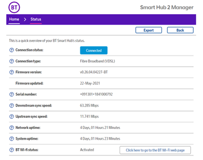

Sadly this was my day 1 on FTTC back in 2015 - not exactly progress
