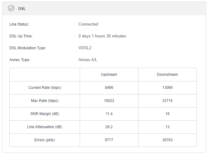

The DSL stats from the router are below (with the connection time reflecting I had just bypassed the face plate on the socket).
What do folks advise? How can I get our speeds back up to the service that I am paying for? All help would be most welcome!

An engineer came to site today and identified that our circuit was still connected to the lightning protection in the local pillar and was sending the signal to ground. With that fixed, and a new master socket fitted for good measure, we are now back up to 58Mbps download and 14Mbps upload - and hopefully a little more when it stabilises.
