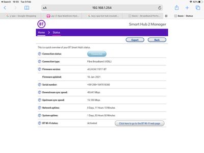

Every time I get my speeds sorted they drop a couple of months later. Engineer came Feb 21. For my speeds back to expected 48 download and 15 upload.
then 17th April the smart hub manager says firmware update. It now shows upload 16 and download 1.2
Checked using 192.192 etc on browser
and sure enough that’s the maximum I am now getting. It’s like BT have capped me again
my package is fibre 2
also the by speed checker now shows receiving 15 download is meeting my expected package which implies My package details have been ammended incorrectly.
I am fed up having to report and get engineer every couple of months.

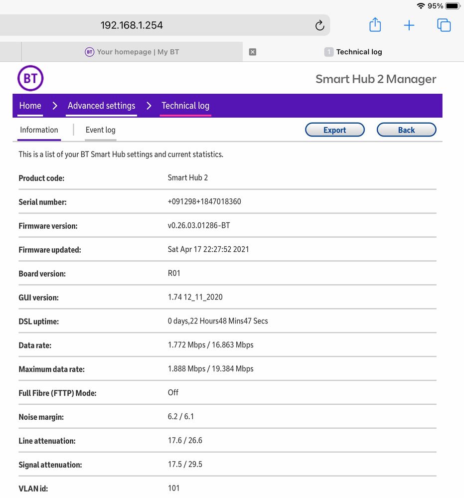

Could you post the hub stats from Advanced settings/technical log/information.
Is there any noise on your line? 17070 option 2, best with corded phone, may get a dull background hum from cordless.

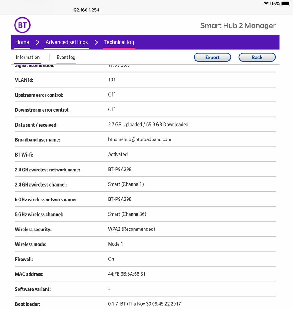

I have attached a screen shot of what I think you mean
we don’t even have a phone now.
the engineer suggested last time that if we don’t use the phone then take it out as can cause interruption ?
