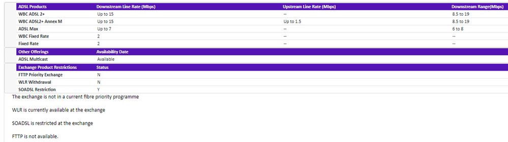

Thanks, wanted to get confirmation that what the developer has said is not possible before taking it to our solicitors.
Yes tried that link and it confirms the speeds. It is not an FTTP Priority Exchange??
Results are in the screenshot, in fact, I've just noticed that it says FTTP is not available, so does that mean there was never any chance of this being FTTP no matter what the developer asked to get isntalled?bt.jpg

You have missed out the cabinet number and exchange name, as without that information, its difficult to tell, as you could just be on an EO cable (Exchange Only).

Ah Sorry, WARE exchange, cabinet 28.

Not good. Can you manage with 15Mbs? It usually fine for most people, provided that you do not want to upload a lot of data, as that is likely to be on 1Mb maximum on ADSL2+.
Cabinet P28   Openreach fibre not available            SG12 7AB
