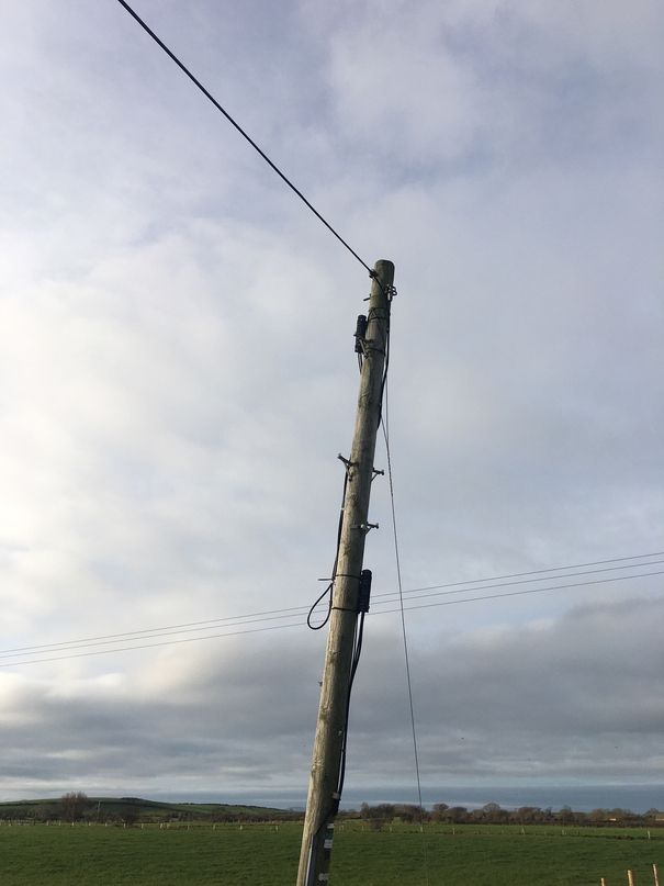

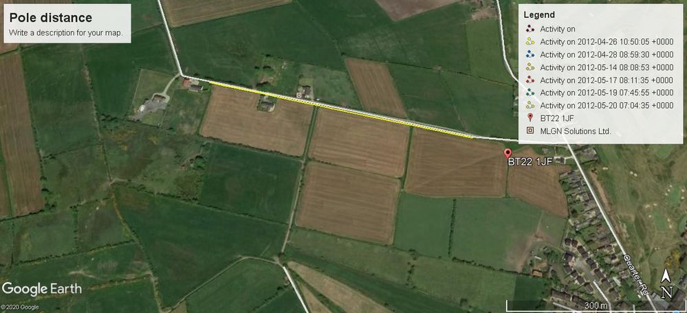

this last pole up the road is 200m into the lane and is about 525m from the pole outside my houselast pole on lane with fibrelast pole on lane with fibre).
There are 8 intermediate poles between me and this pole all about 50m gap except the last interval which is 130m approx( bt line runs underground on these )
what puzzles me is that openreach have bothered at all to extend the fibre at all to the start of the lane as far as this pole which only connects to poles further down the lane so im thinking they intend to extend - see map below from google earth- distance is 526m marked yellow526m with 8 poles between526m with 8 poles between

having looked at the poles up the road with these fibre connector boxes and this last one 200m into the lane am I right in thinking that the fibre has been drooped across down to boxes rather than fed up from underground to service an overhead connection-am I reading this correctly?

That picture of the Telephone Pole doesn’t look like it has any Fibre Equipment/Cabling on it.
Looks like either 10 or 20 pair aerial cable and two Small Cap End Universal Clip Joints.

that looks just like the pole I am connected to and as @Starwire  says does not have FTTP. Just wish it did

yes I wasnt sure about these 2 clip joints on the pole and I may have been thinking that they had something to do with fibre
what led me down this mode of thinking was that they are new and redundant as all the properties on the lane already have phone connections - why add these now
they also are identical to the new clip joints on the poles outside properties on the road up to my lane which the dsl checker confirms as being able to have FTTP
in which case it may be that should one of these eligible properties choose to order FTTP the dsl checker confirms connection overhead so openreach would have to start installing the necessary fibre equipment on the pole not that it is installed already
so with availability up to number 30( 15 houses ) a line would be run independent of any clip joints to any of these houses from the aggregation node ?
or am i not picking up a cbt joint somewhere already installed?
thanks for your help- it is confusing - what are clip joints and why are there two added  on a pole already serving 4 properties ?

Connectorised FTTP Doesn’t use UCJ’s. Universal Clip Joints.
As to why there’s a new one placed on the Pole in the picture I don’t know? Only the person(s) who put it on there probably know.
Also if the Pole had Fibre Equipment/Cabling on it there would be a small yellow hazard label on it saying, Caution Overhead Fibre.
