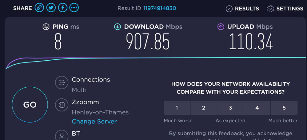

@Mickypd As the others have said, it's rubbish that normal domestic equipment cannot get 900 Mbps. Plenty of people on this forum, including myself, happily get the headline 900 Mbps speeds.
It is absolutely not a con, as most consumer services are contended services, meaning that the overall connections are shared between multiple households and speeds can be affected by usage of others sharing it. This is how they can supply you a 900 Mbps service for £50-60 per month, as opposed to hundreds per month. Additionally, most of the other mainstream ISPs that I had checked don't even give you a guaranteed minimum speed, but simply have a note telling you that the headline speed is an average and the speed you will actually get at any given time is affected by a whole bunch of factors. So if anything, BT are actually being upfront about it.
2016 MacBook Pro and 2018 iPad Pro, testing via ethernet deliver just over 900 Mbps down and 110 Mbps most of the time. During peak periods in the evenings, I have seen it drop to about 850 Mbps. There are only about half a dozen people in the neighborhood on the Openreach full fibre at the moment though. Most are still on FTTC or on cable.
So as more people take out FTTP, I suspect I will see some drops in the top speed more often, but to be honest, I would not notice. It's rare that anyone is maxing out their connection all the time; I certainly don't.  Even more rare that everyone on that particular share is maxing out the service at the same time, therefore it will have no noticeable  impact.
I still think the 900 Mbps is overkill and would wonder what real world benefit anyone would notice in 99.9% of cases, over the Fibre 500 package. But I wanted the higher upload speed, which is why I went with the 900 package.
Run just now (15:38, 2 Sept 2021):
