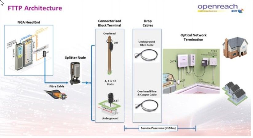

Judging by what is going on around me it is a complete new fibre system, no cabinets, full new network underground, only surfacing (here) at telegraph poles for the final run to homes.  That way they can transfer whole areas in one go, rather than pick them off house by house.  Our street of 14 houses had the foresters here yesterday to clear the path for a new fibre to our one telegraph pole, on a route nowhere near Cabinet 8 in front of my house.  That's how it looks to me - an expert will be here soon to give the proper explanation.

FTTP is delivered from a headend exchange OLT, which is not necessarily your local exchange, to a splitter network to the individual properties ONT

They don't, as I said, the fibre from the exchange goes to a splitter network to be distributed to individual houses. FTTP is a passive optical system (GPON)
