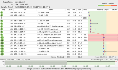

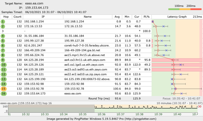

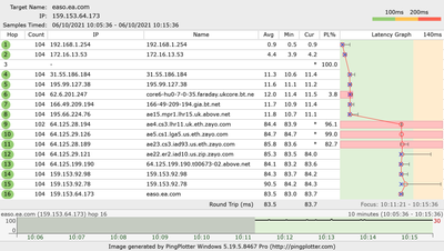

I've ran some tests, and here are the results:
Image 01 - No Netflix | No FIFA Gameplay
Image 02 - Netflix Running | No FIFA Gameplay
Image 03 - Netflix Running | FIFA Gameplay Ongoing (Online Match)
Image 04 - No Netflix | FIFA Gameplay Ongoing (Online Match)
I tested during the online match, during the first half of the game I had Netflix on and my Ping would sit around 19 - 23ms but have constant spikes mainly up to 50's - 80's but sometimes would spike upwards of over 200. Then, for the second half I turned Netflix off, and my ping sat at a stable 13ms throughout with no spikes at all.
